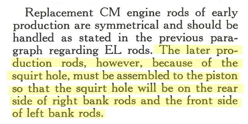

Don't know if this helps but this is from Mercury overhaul and assy manual.

Left bank (drivers side ) holes face forward.
Right bank (pass side) are to face to the rear.
Just realized that this may be confusing according to your location. So this arrangement applies when the steering wheel is on the left. US style.
Left and right sides of a car is always from the drivers seat, left hand is left side and right hand is right side. As far as I know this is not country dependent.
