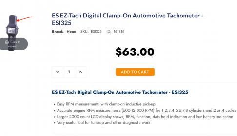

SAXBY2
I 've used the attached for conventional wired spark plug leads. Any suggestions on how to use it with the brass strip to #1 plug, or to another power lead to coil, etc ? It can be set for 4 or 8 cylinder powered by an internal 9 volt battery . The handle is squeezed to open the hole shown by the arrow.
