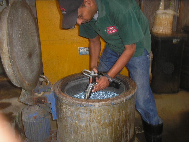

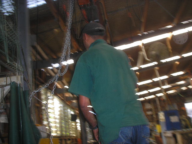

We do maintenance for this chrome shop ,To get the affect we bead blast the bars then just polish the fronts ,a friend needed a wiper motor the supplier in the states didn't have his Chromer any more so he sent down to this Chrome shop then back for assemble ,
