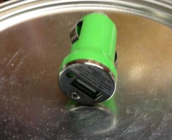

Here what I did, I bought a lighter charger from the Dollar store and took it apart. Connect the positive to ground and negative to batt power, an inline fuse for safety, mount it to a piece of plastic and mount it somewhere on bottom edge of dash.
