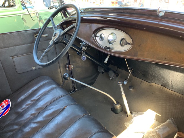

Here are some pics I took of an original car a couple of weeks ago. I was amazed.
