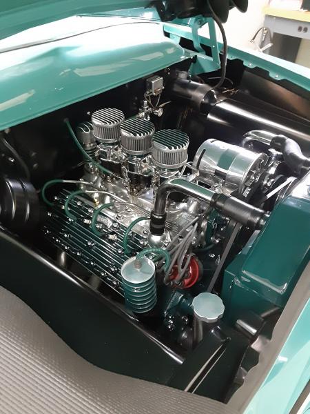

I have NOS Fenton headers, heads, & intake on my '51 Victoria. The gentleman I purchased the car from had saved them for many years in the boxes until he found the right car to use them on.
Stay Safe!
Pat
