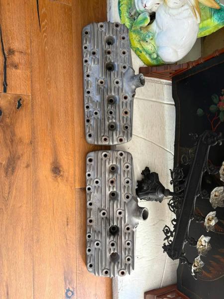

I have a set of c91a heads which I guess would be 1939 vintage. The water inlet is thin and both heads have what appears to be threads on the outside of the water inlet. maybe to help hold the hose on better. Also have a what I believe to be HC set C7RA heads.

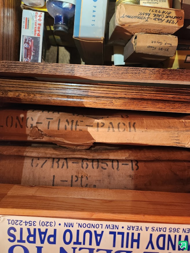

Looks like my father had 2 NOS aluminum sets. One are still in the box, the other he installed on his convertible. @Kube, just to clarify, are these the heads that are near impossible to find? Or were you referring to a different set?
