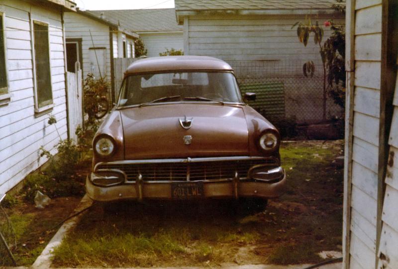

Found a pic of the car when I bought it back in the 80,s. It shows the hood level in the middle but low on the drivers side. If the drivers side were raised level to the fender then the middle would be high as it is now.
It seems (to me) that the ears were drawn down at that point.

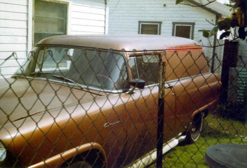

I think that is a '55 Hood. Maybe the whole car is a 55. The '56 models did not have the belt moulding all around the bottom of the windows, but all '55 models had it, even the Mainline models. Pic doesn't show the grille, but that would be a dead giveaway.

Lols, got me a frankinford. This is not the only thing screwed up on the car. Rear door is also off as the license plate holder is not the same as a 56 and rear glass does not line up correctly. Pic of car when I bought it and the data plate. You can see in thep ic that the hood was cockeyed even then.
