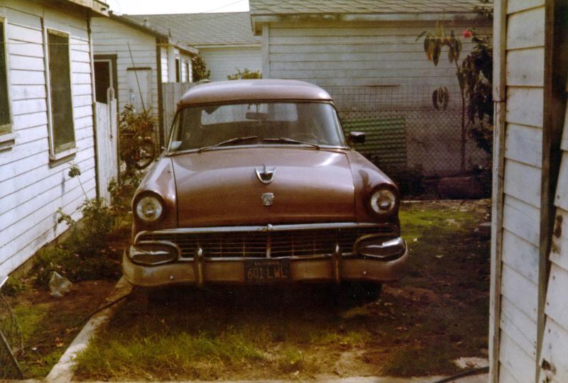

Thanks will try the felt thing. The hood does bow in the center some but think it has been that way since day i bought it, 1980s. I enclosed pics of original car and you can see where it is level in the center but dips down at the ends. Also enclosed pic of the mounting area where someone has welded in a piece where I assume it had cracked. As far as the hood bow I will probably let the body shop work on that as I am to the point I do not want to screw it up. Lol
