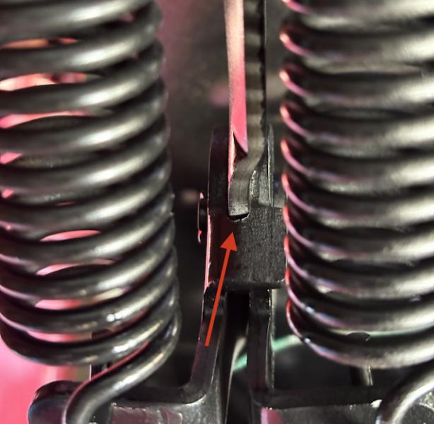

After examining what limited the hood opening I located the stop tab within the Spring Assist hinge on each side stopped the hood from opening further. After propping the hood open with a stick - took the pressure off the spring assists and removed them both. Using a strong turnbuckle and bolts attached to the open ends of the hinge I closed the hinge a little bit so I could access the stop tab. Using a Dremel I notched the tabs on both hinges about 1/8". After re-installation the hood opened almost 28" at the front. Before it only opened about 23-1/2". 1/8" relief gained 4-1/2" opening more.
In hinge photo note RED arrow pointing at stop tab where I notched it.
