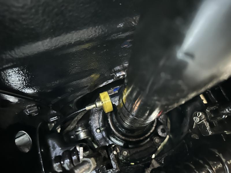

After refitting the rear end of the 34, I did up the speedo cable nut on the turtle, and promptly broke it, because like a dummy, used a set of slip jaws to tighten it,
It was a fairly new cable, so thought I could fix the nut.
I turned up a new nut from nylon, the machined a sleave to fit over it, then cut the new nut in half ,slipped it over the end of the cable then slipped the sleave over the whole thing and screwed it onto the turtle, came out nice,

Thanks for the enlarged pic Trevor. looks like the left side eng mount bolt is not tight
