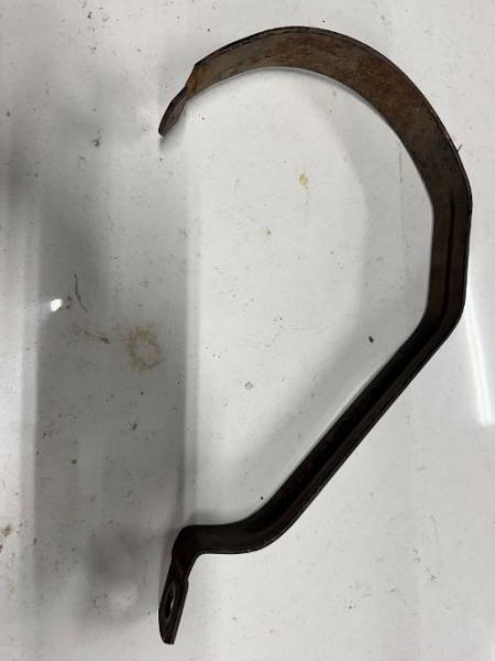

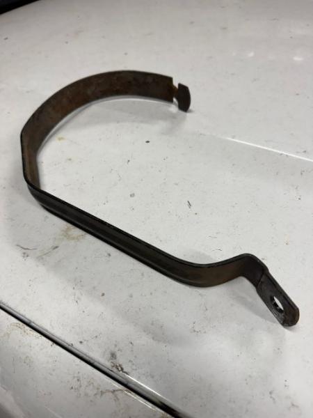

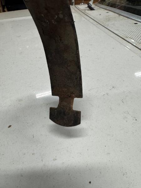

Better shots of the "loop" strap for you
