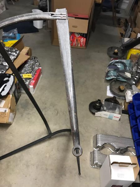

Here are the first 7 photos of my current top and bows. Pretty rough. I know the current top material (not much left) was a replacement top from the late 50s or early 60s, done in San Luis Obispo.

Final 6 pics of my top bows and irons.
Anyone have any ideas what this came off of is appreciated.

Hi Rich,
I just had a thought. Are there any casting numbers on the metal parts? Ford was pretty good about doing that. It may narrow down your search.
