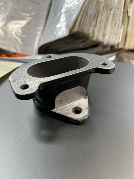

I found it "easier" to use the "original" 32 intake manifold and use the two barrel adapter. I can change it back to the "original DL" set up in 5 minutes. ALSO, I later found that Ford of Canada made one which I "know" am using. As you can see I had to modify the aluminum aftermarket one....I think I have one or two left IF needed. They work great for the ones who want to both retain the "original" look AND can be put back to "concours" correct in 5 minutes time.
