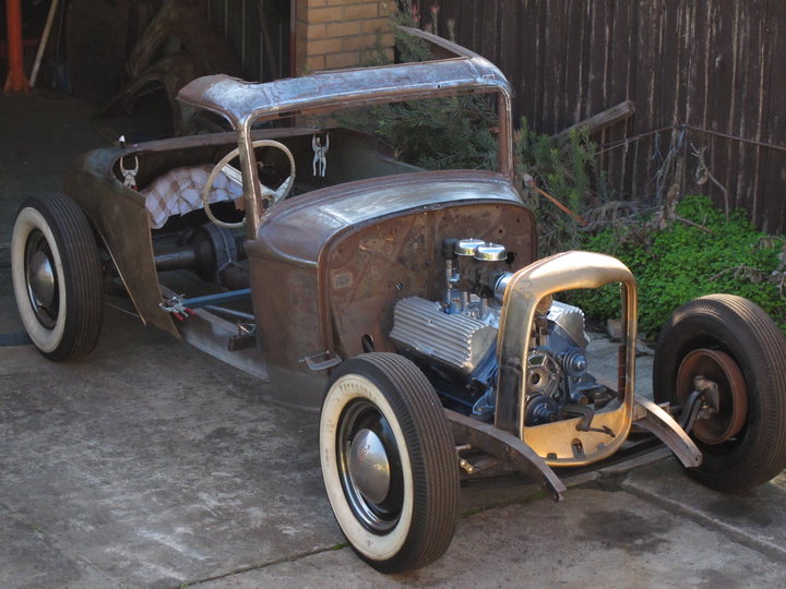

We like to help, but we need pictures for payment !!! It's not a Mopar or a 49 Chevy, it's a 32 for Gods sakes.
Thanks for the picture. Nice project. What is the story on the car, looks like you may have had it cut apart to save on shipping?
Thanks, I got it from a guy all cut up like that, you would have to be pretty tight to cut up a body to ship it :/
