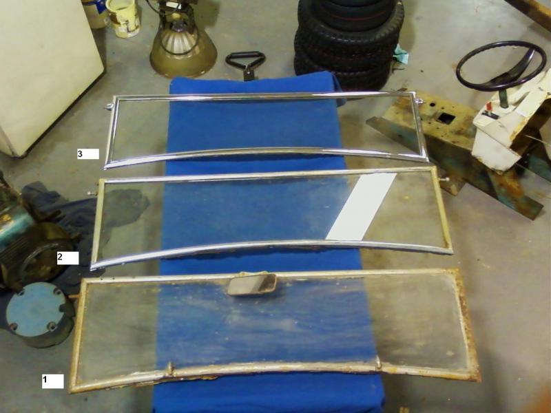

I have 3 windshield frames. I am trying to figure out which of them is original (if any). Any help would be appreciated.
They have almost identical dimensions.
#1 & #3 have holes for finger pulls. #2 has none.
#1 & #2 have almost a round cross section. #3 is more of an oval.

If it's a deluxe roadster wind screen frame it is shorter [I think 13 inches high while mine is 15 inches high] than the non deluxe shown in the picture below and it is round on the bottom and it has two finger pulls. This is a non deluxe-B 40, top-o-frame. Not much help seen here. skip.

Deluxe is 13-1/2 inch high. [chrome] Standard is 15+ inches high [paint] all have finger pullers. to be sure orginial windshield frames are butt close on top L / R corners as repro's have a pie shape opening. # 1 looks to be a orginial [ most all chrome ones rust out in lower corners.]:o
The corner joints on original frames were electrically butt welded meaning there was no filler steel used in the welding process which rounds out the joint as seen in replacement/repro frames. As Pete said your #1 appears to be the real deal.
