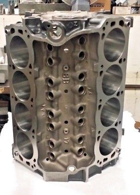

My friend has a 1991 Ford in his car has a carb on it trying to find a camshaft for it he wants to go roller but no one can tell us for sure what cam will work for his block cause in 1989 to 1999 they use the same blocks we were told but in 1993 they had roller lifters most of the block were set up for roller lifters
So can we fit a retro fit cam in it cause it is the one he only can find that he likes
Couple pictures of the blocks one a roller block one a none roller one
First one is the roller one

I’d get the numbers and date code off it and call the cam grinder. They should know. I know for some applications they make roller lifters to retrofit pre roller blocks.
The trouble is the block will take both but can't find the cam he wants in the stock roller cam just in the retro one we going to call comp cam on Thursday and find out

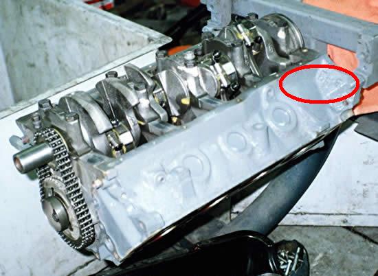

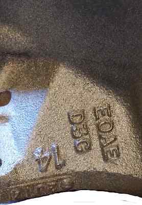

I'd appreciate it if you could tell me where the block numbers are. I have. Perhaps, a 94 302.. I've tried a bit to find them but not good enough.
You should have asked ... :D
The Casting ID will be found @ the starter...
The Engine Assembly Date ID will (may) be found as the photo shows...
The Partial VIN Stamp (1968- ) will be found per photo...
The 302/5.0L has a long service history (1968-2001) so there are many differences to be aware of.
