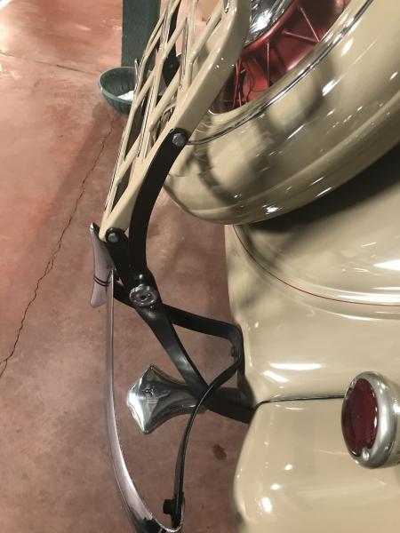

Yup, they’re not see often. I continue to scrounge for the final remaining components for mine.

Well now! An interesting chain of events has arisen as to the fitment of the rack I have fitting on my 36 coupe. The man I bought the rack from assured me it would fit a coupe.
Initially I was a little confused as to how the mounting brackets for the rack I have would attach to the '36 bumper bars, due to the fact that the '35-36 rear bumpers do not attach to the frame in a conventional manner, using only a very large bolt through the end of the frame in lieu of two large bolts through the side of the frame, which is the common way to attach the bumper bars.
I now know, thanks to the enlarged pix that 'petehoovie' attached, the rack attachment bars mount below the original bumper bars, extending up to mount on the exterior side of the frame.

This car, a 35 cabriolet is in the LeMay museum "annex" in the former Marymount military academy in Tacoma. There are a fair number of volunteers at the facility and I'm sure should you give them a call, that one would take some detail photos of the mounting configuration. I would think it would be similar to that of a coupe.
It is interesting to note that although this appears to be a quality restoration, no one took the time to buff off the grade 5 markings on the hex bolts.
Thank you "petehoovie" for the enlarged photos of the luggage rack on the '35 Cab.
My rack did not come with any fasteners so I had to be creative. I used stainless steel 5/16 bolts, washers and nuts. ground off the head markings and re-polished the heads.
Reviewing the pix in "petehovies" enlargements, I noted the four square holes in the vertical bars. As to what the purpose is or was I have no idea. I cut down four stainless steel 5/16 carriage bolts, the square shoulders of which fit the square holes perfectly and provided a finished look to the rack.
