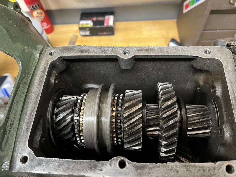

Thanks again for all the advice. I will pressure test the #2 cylinder and get a better idea when my pressure loss is occurring. Will also run it with MMO this weekend. I am thinking of running it as is because it starts right up and runs pretty smooth. Am also musing about next step...Transmission. I show SN #18-2460313 and from what I can ascertain, it is from 1936. However, upon inspection, I see some teeth have been crunched a bit. Attaching a pic to determine if a simple cleaning will do, or if I should rip it down and replace the bad gear. TIA for any advice on this...
If it were me, I would go through the transmission from stem to stern and clean out the case and replace any gears or bearings that look questionable. A lot easier to make the repairs while it is out.
Cheers!View attachment 592303
592303
I'd rebuild it with '39 parts. The syncros are a modern design and used by Ford for many years after.

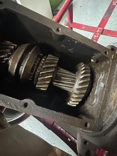

For comparison, I just went through the '39 trans with the later improved synchro hub in my '34. Here is what the improved (1946 to 1954) synchro hub looks like.
