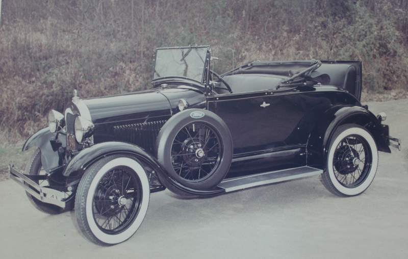

On my 1929 Roadster, I used plain ole roofing repair cement with fibers. I never did have any odors and when you peck on the panels with your knuckles, it sounds solid as a rock. You just apply it with an old paintbrush. And it's inexpensive. I did mine at least forty years ago and it still is holding up well.
MIKE :)
