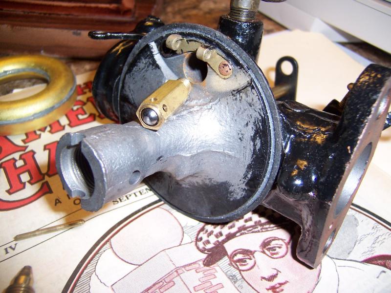

need picture on the workings of a1926 Nh carburetor need to rebuild have done model A's don't know anything about aT have several books but nothing on carberator rebuild i'm a new guy to T's

If working on T's, you should get a re-print copy of Model T Ford Service, that is the complete repair bible for the T by the Ford Company. Details on the NH are in this book, which covers in detail the 1924 car , and Improved Car '26-'27 , but is good for any year T. Get your copy, 296 pages plus hundreds of photos, from any parts vendor for T parts. Carb Overhaul is in Chapter XXVII.
Here are some pics, the first one shows the tiny vents, these are plugged on the outside, remove the plugs and clean out the vents, then re-plug with small dia brass rod. The rest of overhaul is replacing the needle, seat, float needle and seat, and being sure the butterfly work. Then set the float to factory specs.

Opps, posted the wrong picture.
That one shows the crummy Grose jet valve, don't use these in gravity T fed carb, they stick either open (gas runs out) or closed (T does not run). Use the stock needle type or vitron tip, much better than these chinese crummy ball valves.
Here is the pics showing the vent lines to clean out and how to recap the openings with bit of brass stud after cleaning the passages.
