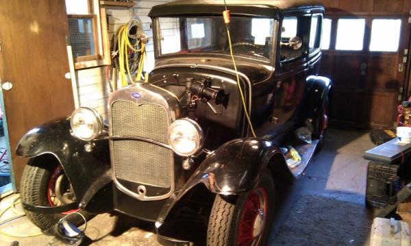

Great looking tudor. I really like the turn signal lights up there. Got a close up of how you mounted them? I have mine mounted where the bumper brackets used to be on frame horn,but yours looks alot better to me. Thanks . Keep at it youll be done in no time
Those are motor cycle light, old Harley type. I made a flat bracket that used the stud for the headlight that was about 2-2 1/2" long with a hole in each end one for the headlight stud and the other for the signal light stud. I drilled a hole in the bottom of the headlight (used a rubber grommet) for the wiring so it all fed thru the headlight wire loom.
