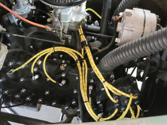

I have used 8mm on my 53 Ford flathead for the last 40 years. No problems.
As I recall the 8MM wire would not fit through the original wire loom holes so I modified the wire looms. Measure the holes in your wire looms to check this out.

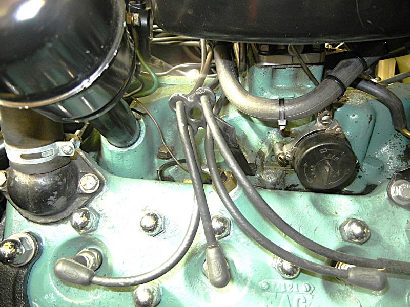

I have what I thought were original style wires on my 8BA. Bought around 2017. They have a FoMoCo logo on the plug boots. I thought they were from Dennis Carpenter, but not sure now. They were fully built when I got them. I really wanted a "1950" look. Not sure I succeeded now?

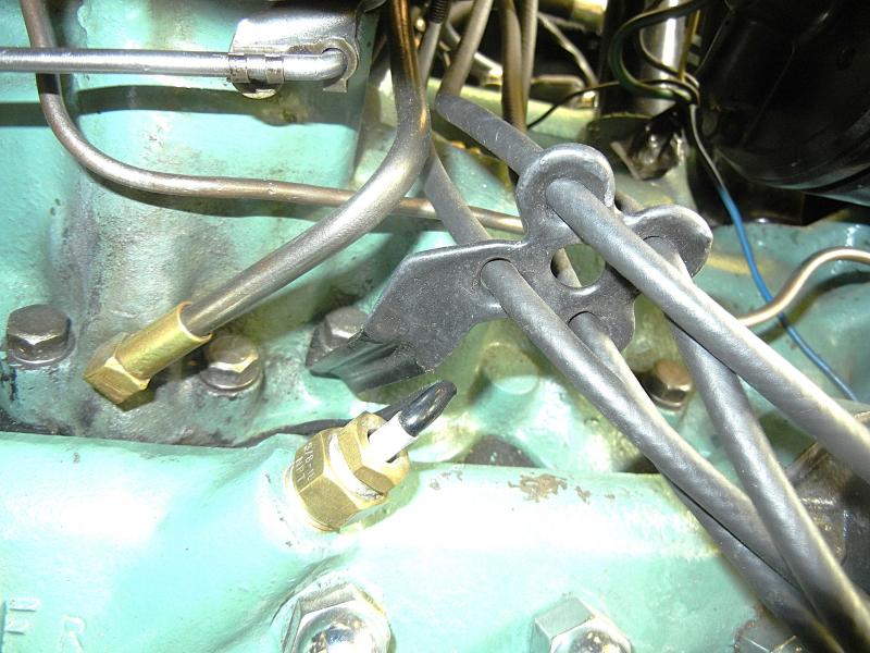

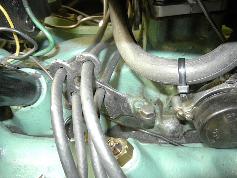

The correct "wire looms" for a 53'. The last picture shows the brackets (looms) that came on my car, when I bought it (on the right) and the correct ones one the left.

Those "all in ones" are earlier ('49-'50 I think; my '51 has the later "individuals"). I always wondered if the early ones didn't cause frequent crossfires.
I think they were dipped in a vinyl rubber coating.
You are correct they were dipped in vinyl rubber origionaly and when I redid mine, I dipped them in black Plasti Dip.
