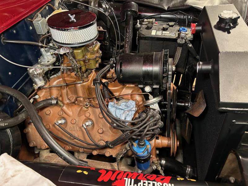

In order to start my recently acquired engine I installed a “Model A” fuel tank which worked quite well, lol.

Looks like you have the same Mr. Gasket air cleaner that i have on my '51.the research i had done said was perfect size for the 239. also looks good. Tom.
