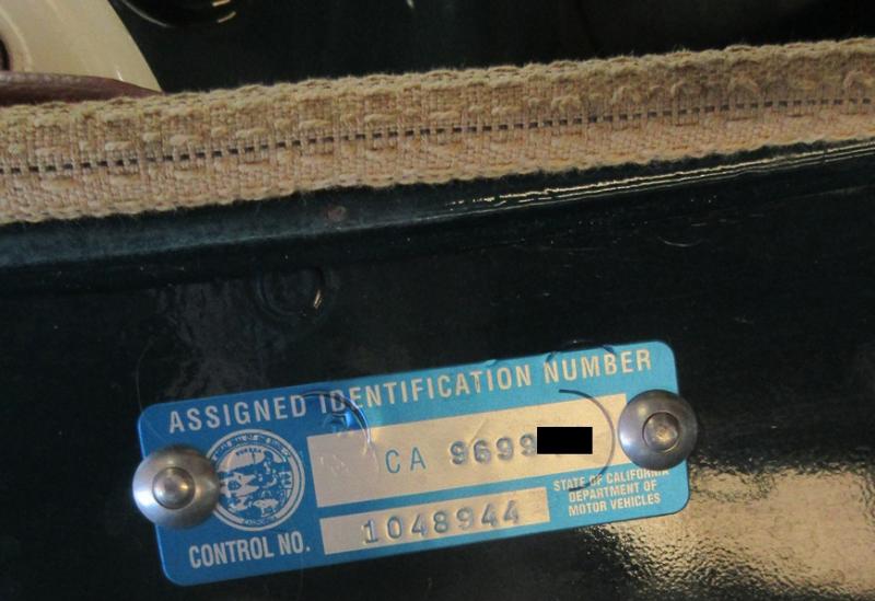

The Virginia title for my coupe showed the engine number as the serial number. Since I replaced the old cracked block with another good one, I wanted to get the title updated to have the documentation in order. I inquired at my local DMV and was given a form. I sent that in with a check and a little over 2 months later, an agent from the DMV called and said he would be in my area the next day. He looked at the engine number in the car and at the old cracked block that I had saved for this purpose. He said the serial number on the title would stay the same and he would have the new engine number noted on the updated title. He said he could come back and install a number plate on the firewall or door jamb or I could make one and install it or I could do nothing. I decided to get an official VA DMV plate. I was surprised by the casualness of the verification, I have to say.
picture.php
Wow, lucky you. If I lived in VA I'd be doing that.
