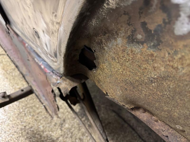

Hi There,
I am working on my '31 Tudor and have gotten to the Inner Fenders.
As is normal, they are pretty rotted out. Patch panels for the Tudor are out of stock and no one can tell me if/when they will be back. Most folks tell me that the patch panels need a lot of fettling anyway so I may as well just buck up and patch what I have. That makes sense.
I am new to all of this and trying to come up with a game plan on how to attack the repair. I am not worried about originality and I plan on running without fenders.
Here is what I am dealing with:
561699
561700
561701

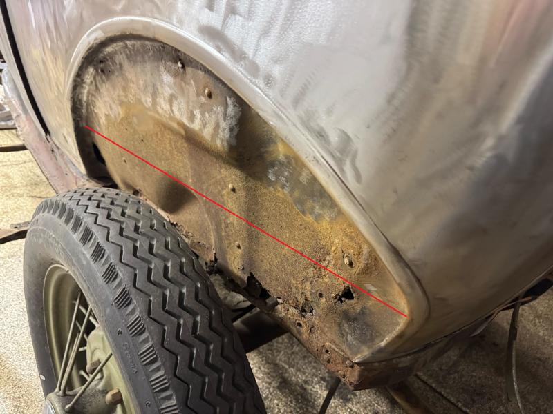

One thought is to cut out the rusty stuff around the holes and form patches to match the contour around each area and weld in. The bottom area has me worried because it is pretty lumpy and bumpy.
The second thought is to cut somewhere around the red line and make a large flat panel from there down to the sub rail and be done with it. In a similar vein, I could cut around the radius of the wheel well around the curved flange and do a flat complete flat panel all the way around similar to a roadster or coupe well.
561702
Thoughts on how to tackle this from folks that have been here before?

Your idea of a flat panel from the red line down is not without merit. What you need to be most concerned about is the concave section (with rounded top area) just in front of the 2 vertical rivets. That allows room for the swing of the shock arm when turning and taking rear body lean into account. It's mostly overkill in degree but based on the body leaning in a sharp turn at speed. (In the case of the pictures shown, driver side, this would be a sharp left turn.) Most of the other curved areas are concerned with rear seat clearance.
Thanks for that info. I will likely be moving to tube shocks so clearance for the originals won't be an issue.

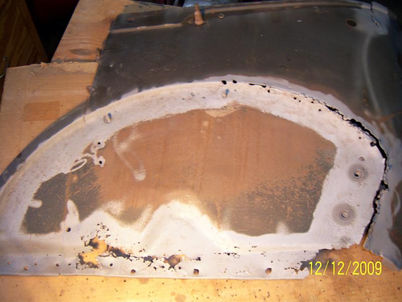

I have fixed worse rust-outs on my 29 phaeton. However, I removed the quarterpanels before I repaired the rust-outs. I always try to save good original sheetmetal, if at all possible. Below are some pictures of the rust repairs on my car, starting from left to right. I sandblast the rusted areas first to get a good base for the MIG/gas welding repairs.
Rusty Nelson
Nice work Rusty. I am inspired by your abilities.

I think this is where I am going to end up. Cut out the bad spots and form small patches. I have to do some body repair on the rear corner so cutting out a large chunk of the inner fender will provide access for the repair. Most of the rust is in the bottom two inches so I think I will form a long patch with a flange to replace that. I may cut a larger area out of the drivers side so I can access the sub rail for repair as well.

Not much new to report. All of my lines on replacement inner fenders have turned out to be scams. Sigh. What is it with people?
I did get brave enough to cut out some rusty metal. I also created an access hole so I could get a dolly behind the fender. I started to move some metal to fix the dent but hammering with my left hand and contorting to get the dolly in the right spot is proving difficult. Ha. I am happy with the direction things are going but certainly need a lot more work.
I am going to talk the wife into being my dolly Doll and see if we can make more progress. I will chop the bottom 2 inches or so out of the fender liner and assess the repairs that need to be done to the sub rail.

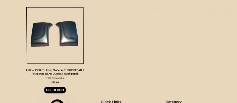

Here is a sample pic of some of the Die Stamped parts we make.
I am trying to add more parts as time permits.
Our website is ahoogaparts.com and I can be reached at dale@ahoogaparts.com if you have any questions.
Thank you everyone and Happy Model "A"ing
Dale A.
