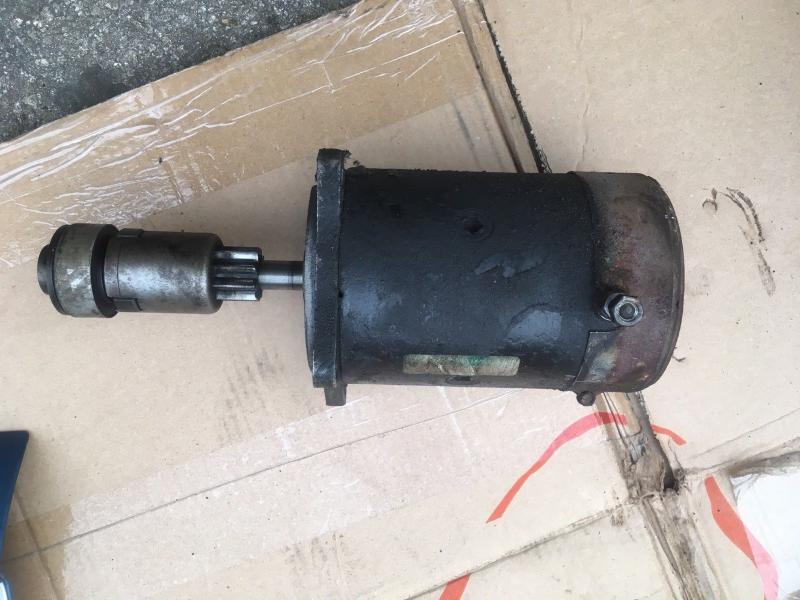

Hi All,
Somewhat related to these post, I have a question on how to troubleshoot a bendix that isn't engaging. I have a 55 Fairlane, 292, manual transmission, 6v system. I've never had starter issues with this car, and the starter is one of the few things I haven't touched. Yesterday the car was starting and running well. But this morning when I went to start it the starter motor just spun and didn't engage with the flywheel. I hooked up a fresh battery, and no luck. Rolled it down the hill to push start it, drove it home, and once in the garage shut it off, and tried to re-start but it wouldn't engage.
Update: in the post since it is fresh ... I gave it another try, letting the starter spin for 10 seconds and it then engaged.
Anyone out there have experience with this issue, and what is the best way to troubleshoot it before taking the starter out?
No matter what the reason, I don't think you have a choice other than to remove the starter.
I would begin by removing starter drive from the starter shaft and sloshing it around in a can of solvent (gasoline or mineral spirits) to free it up. Then see if the gear will twirl around to the "engaged" position. Do not oil the drive before re-installation. Oil will just gum it up again and cause it to stick.
Inspect that big spring at the back and see if it is cracked or broken. A new starter drive will be required unless you can cannibalize a junk one.
You're right Dave,
I pulled the starter, came out easily, and I found that in the starter drive mechanism there is a thin washer or disc spring that holds tension on the Folo-Thru device. Unfortunately this washer split in half.
