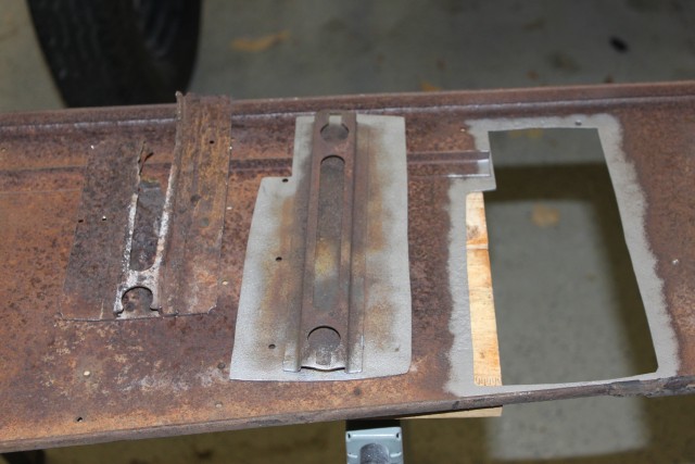

Here is a photo of what I am doing to fix one of mine. The rear mounting bracket had rusted away, along with the metal above it. The other running board was too damaged to use, but one of its brackets was OK, so I am using the bracket and the surrounding metal as a patch.

I got a classic lesson in that effect when I welded in the patch (in the photo in my first post in this thread). When I started welding, the board was flat, and I had the patch perfectly parallel with the rest of the board. When I got done welding (one inch at a time), the board had developed a twist. This is the natural effect of shrinling the cetner of a rectangle, creating radial tension out from the center, and tangential compression around the edges. I spent a little while doing hammer-and-dolly on the weld bead, and about half of it want away. Later I will heating and planishing the weld bead, and I bet I will be able to get it flat again. Simply twisting the board does nothing; it just pops into the opposite twist.
