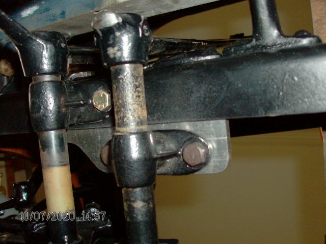

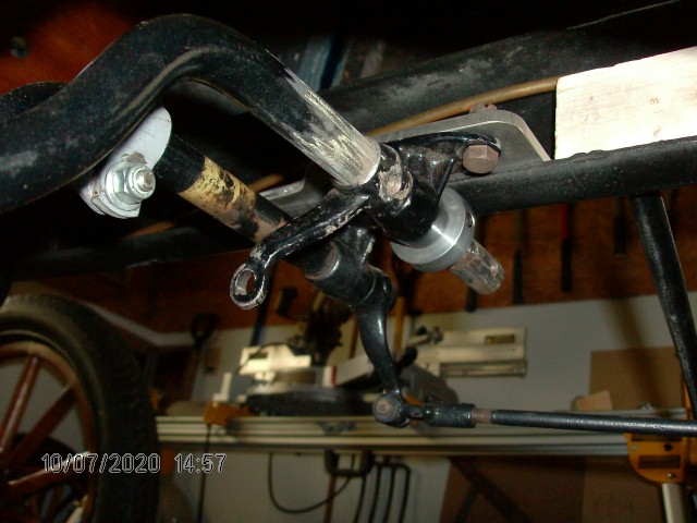

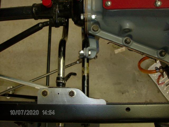

Tom Carnegie wrote an alternative solution to mounting the Ruckstell shift lever for his club's news letter. I thought Tom had an elegant solution so I downloaded the article. I ended up buying an intact parking brake lever and apparatus on Ebay from a 1923 Model T and so far, I'm pleased with how this is turning out. I had the plates and bushing fabricated at a local shop. I'll be going back there eventually so they can fabricate an actuation rod that looks like the actuation rods for the parking brake except the "hump" for clearance around the radius rod is in a different place (the conduit doesn't suit me). I haven't bent the shift lever yet. Before I start drilling holes:

As you can see, a Ruckstell shifter requires very little throw distance. At the base of your hand lever-where it comes through the floor- it only moves a couple of inches. Of course, the longer your lever, the longer the distance of the throw at the top will be at the top of the lever. Yes, "high" is out of Ruckstell.

Thanks for the info, gz. I haven't rode in a car with the Ruckstell yet and I'm having an actuation rod manufactured. I'd rather not have to lengthen the hole in the floorboard to accomodate the shift lever in the aft-most "Ruckstell" position. In the written material, I didn't get the impression that the hole had to be modified to acomodate the new shift lever.
