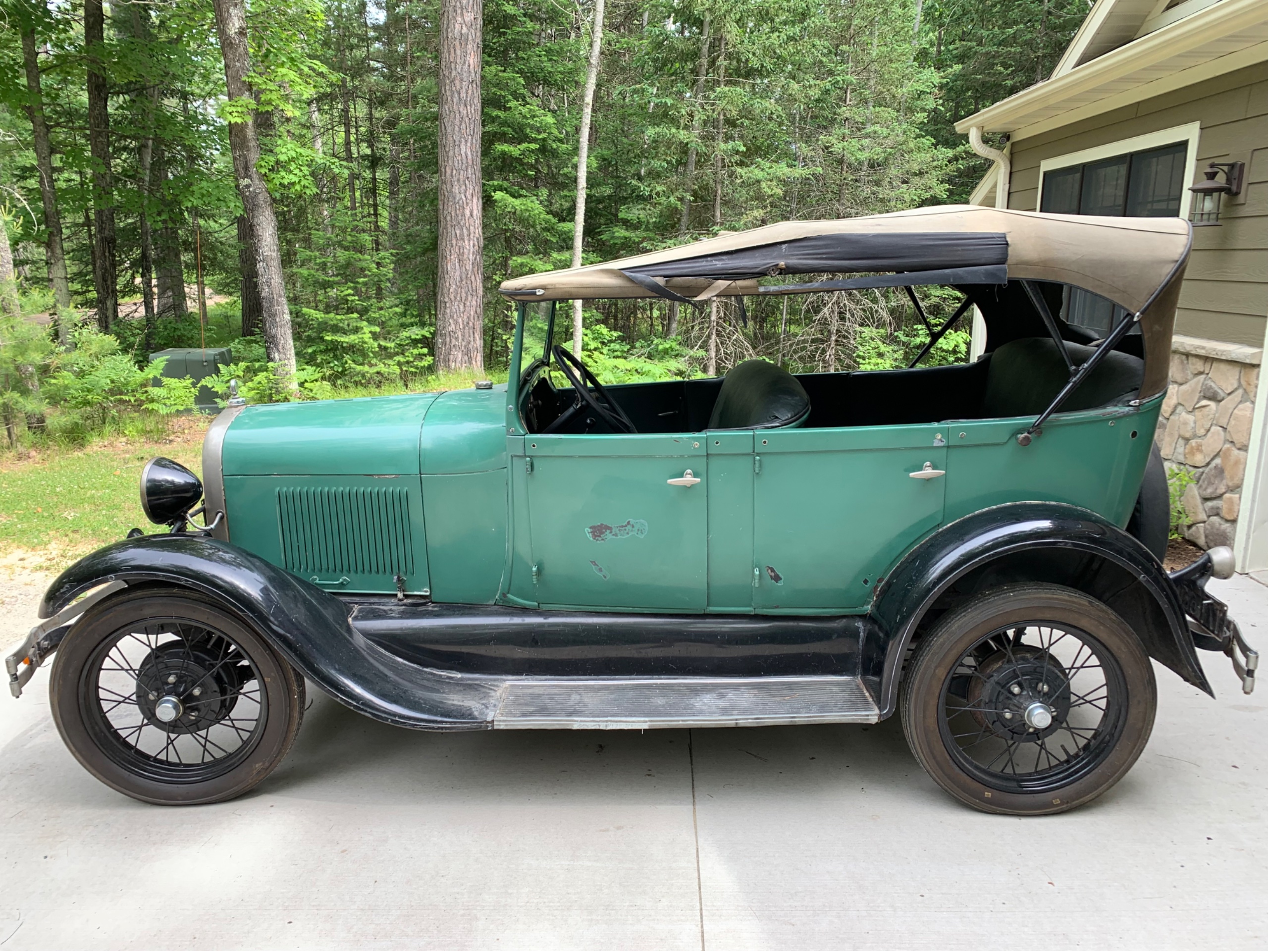

When lowering the top on my '29 phaeton the irons bind up and won't lay flat in the stirrups, if I pull the clips located on #3 and #4 bows the irons will then lay flat. is this the normal procedure when lowering the top? Never had a top before and haven't seen a procedure written out for this. Don't have the covering on any of the bows or the top material installed yet, just trying to get the irons set before procceding any farther

Is this a photo of your irons or are you just using it to illustrate where the binding happens?
These are not my irons, they were easier to use to ask my question. I didn't want to remove mine from the car, remove the wood bows to get a good picture. I got lazy I guess, but they are an accurate representation. Just trying to get a bit of knowledge.
No worries. I took that photo, so I was momentarily confused. :D

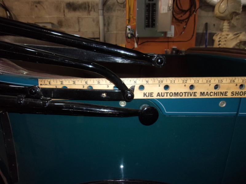

Here is the distance from the body mount pivot point, to the bracket mounted on the forward edge of #4 iron. Mine is about 11" center to center. Maybe a Phaeton driver could measure their car and see how it compares. I have a blue print of the irons but it is impossible to make out any measurements.

Now that's interesting.I have a July of 28 phaeton in my cellar,6 feet under my ****.I just measured mine,that 11 inch measurement on yours is 9 inches on mine.I always thought the irons on the 28's and 29's were the same.I never paid that much attention to the changes and details of the first two year cars,I always preferred 30's and 31's.
So if I move mine and clamp it at the 9" measurement, the irons will lay down flat. Looks like someone modified this set of irons at some point. Altho don't have a clue why, even if these were on some other car, wagon etc., they would never lay down. Now time to integrate the #1 irons into the set and see if there are any more surprises. Thanx a bunch for checking your cars for me.
