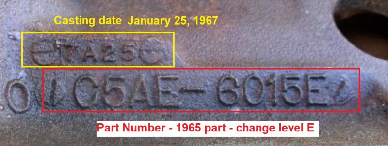

I'm thinking your looking at the raised cast numbers. He's talking about numbers that have been stamped not cast. Serial numbers are stamped as they change for each engine. Casting numbers are for a whole series of engines and the date cast changes daily - sometimes for each shift or hourly.
Ford has pretty much followed the same casting and part number sequencing since the Rouge opened.
