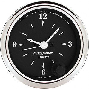

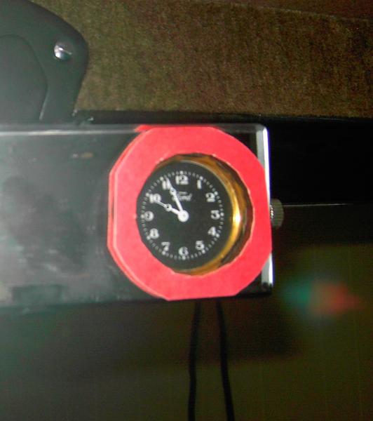

Every mirror clock I have owned (including the one shown) stopped running from for two reasons: 1) Congealed lubricant; 2) Wear of the shafts & gears from the Model A's vibration. The solution is to use a quartz crystal clock with a battery.

Yeah, I did that but the battery went dead.
