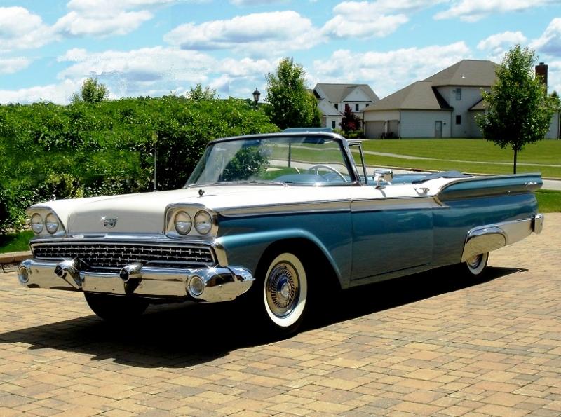

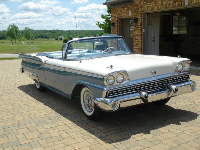

I am in process of trying to make my tail lights, rear turn signal lights and brake lights brighter on my 59 Ford. Has anyone had any luck with LED bulbs for this application? They make such bulbs that fit into the existing socket, but as I was ready to order, noticed this information regarding their use as turn signals bulbs (using existing flasher).
"Your vehicle may require an LED compatible Flasher or Load Resistor. LED brake/tail lamps will not flash with most stock flasher units due to their extremely low current draw ...Please See More LED Car Bulb Notes
For best results the LED color should be the same as the lens color. If bulb is behind a clear lens, use the appropriate color for turn and brake light functions. ...Please See More LED Car Bulb Notes."
I don't know about changing to an LED compatible Flasher or Load Resistor. Is this a big deal and does it work? Any ideas on this subject will be appreciated.
Attached are pictures of my car.
Fritz
