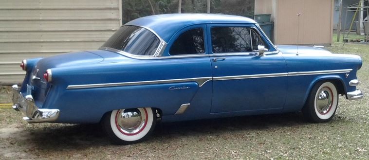

I'm going to attempt to attach a couple of car pics.

Nice coupe!
Where did you get your coupe? Looks exactly like my old car that I sold to a man in Georgia about 5-6 years ago.
In a post on another thread he said he bought the car from a Craigs List add in Fort White, Florida.

34pickup, I see someone be me back on with the answer to your question.
Buy the vin on mine it was built in Ca. Do you remember any details on the one you sold?
Well I didn't have it long before I sold it, I realized I had too many cars.
Mine had a 302/C4 auto trans out of what I think was a 1970s era car. It was originally a V8/overdrive car with a 3 on the tree column shift before someone changed it. The original manual column shift was rigged up as the automatic shifter. It still had the overdrive emblem on the trunk. It had a factory power brake which had been removed. It had no title, which was not required in either Alabama or Georgia. It needed restoration as the paint was faded but same color as yours. I sold it to a man from a small town west of Atlanta but I forgot which town.
