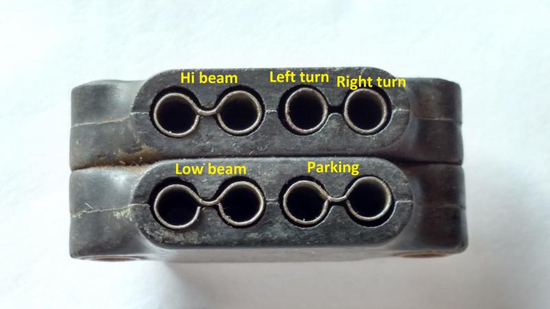

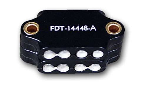

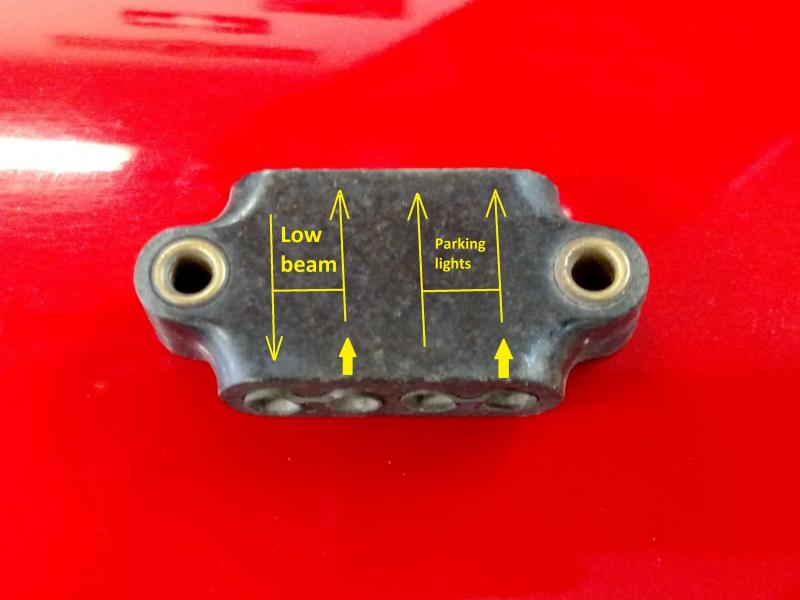

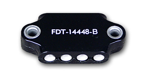

I think you are talking about the turn signal switch in the steering column. That is the case with my 56 Tbird as well. But the wires from that switch exit the steering column and go into a wiring junction box under the dash, then exit that box and go to the rear lights, dashboard and another wiring junction box on the front left inner fender where they then are distributed to all of the front lights and turn signals. Some wires actually cross over to a smaller junction box on the right front inner fender and ultimately go to the headlamp hi and low beams, parking light and turn signal.
I just learned all this when (with help from this forum) I had to rewire the larger junction box on the left front to correct a problem with my front turn signals. There are a total of 16 terminal connections on the left front terminal box, 8 on each siide.
