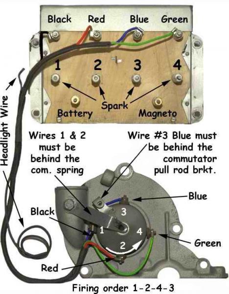

Taking the communtator off isn't necessary, but it makes it a whole lot easier to attach the wires. And taking it off is a really simple job.
And in case you need any guidance on which new wires go where:
