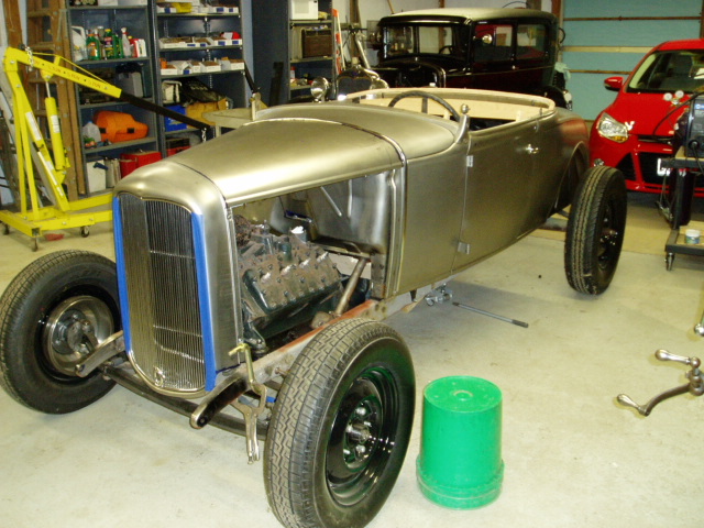

Brookville roadster makes individual parts and complete bodies.
They have a free cataloge that shows all the body parts they have.
I've looked at Brookville. I would absolutely piece something together with their stuff and an original cowl, and I would actually like to, but figure the costs. $700 per door, $400 sub rails and everything adds up. I'm struggling because 45 mph may have never looked so good since potentially an A needing some TLC can be had for the same cost as a Brookville body
