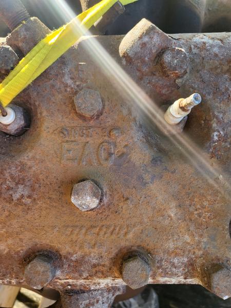

Now the saga really begins. Went an picked up a couple more flatheads. Turned the 8BA over with a crowbar, the EAC could not mount on my cradle so did not want to spin the entire engine.
Will be tearing these down over the next few months. Hopefully, the 59A will find a machine shop to see if it is feasible to sleeve and rebuild. Might bite the bullet and ship it to H&H.
Did not realize that the EAC Mercury has different engine mounts. Might be an issue for what I have planned for it. Is there other differences between the 8BA
and the EAC?
This particular 8BA has a truck oil pan, but it is not an RT engine, is this common?

There are no "motor mounts" on a flathead. The mounts are on the water pumps. There are different styles for cars and truck, but since the water pumps all interchange, it is not a problem. There are 3 basic types of 8BA series water pumps. The Ford cars have an angled mount on the bottom of the pump, the trucks have an "Ear" extending out to the side, and the Mercury pumps have a similar ear, except that it is slightly smaller and mounts higher.

With engines this old, you really have no idea what they really are. People have been swapping parts on late model ('49-'53) flatheads for seventy years. Actually, the only real difference is if you have a Mercury 4" stroke crankshaft in them. That is the first thing I would check for. The numbers in your pictures are used in the production process and seem to be undecipherable. The only meaningful numbers may be stamped on the top of the block. They are the production date of the engine. Let me see if I can find that article. Go to this site for more information : https://myflatheadford.com/5988-2/.
