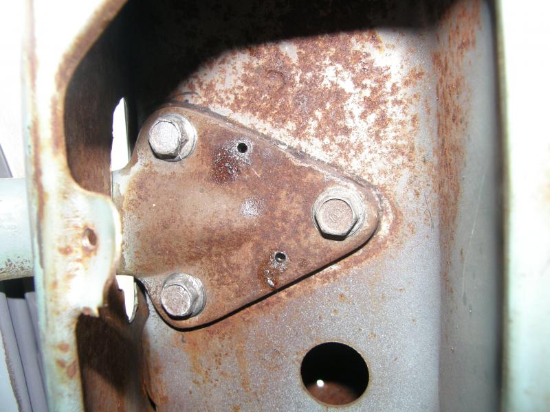

I just R&R'd both my doors. Before I removed them I drilled two offset 1/8" holes in the hinges (both sides). When I reinstalled, I stuck two 1/8" drill bits in the holes and the hinges went back into the doors exactly where they came out. The doors aligned perfectly!
Great idea, but I think his doors are already off, so it's too late now, but once he finally gets the doors where he wants them, he could go ahead and drill the holes in case he ever needs to remove a door again.
I did something similar. After I got the doors and hinges where I wanted them, I traced around the hinges with a fine black ink marking pen both on the doors and the cowl. You need to get up real close to see the marking though. Eliminates the need for drilling holes, but the hole locating method would be way easier for re-installation of doors and hinges.
