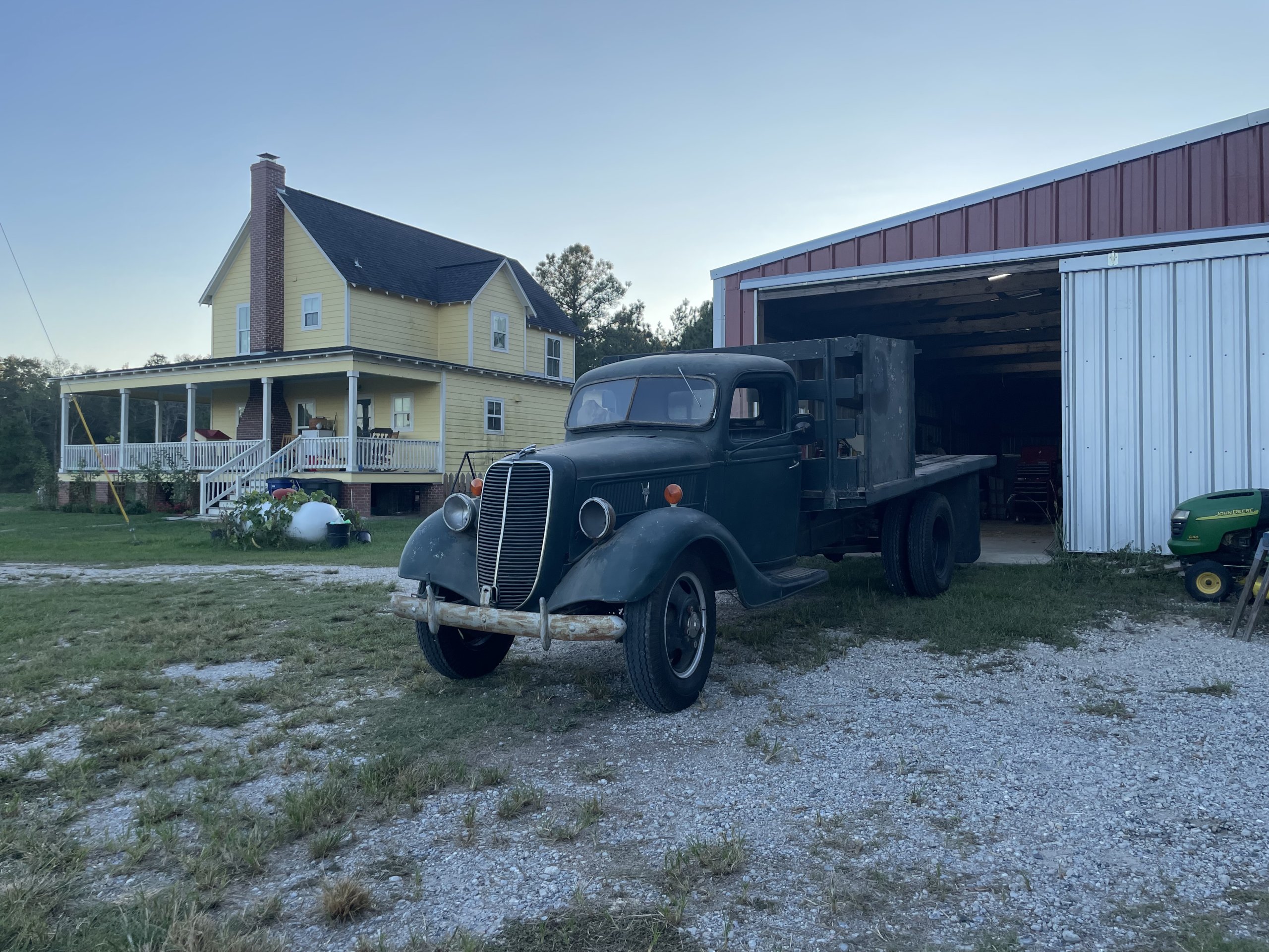

Here’s a picture of my truck. Just put new 7.50-20’s on it back in the spring. A friend of my dad mounted them for me. He used to work at a tire shop when he was a teenager and wasn’t the least bit concerned about the old lock ring rims! “There ain’t nothin wrong with those wheels” he said. It needs new kingpins and bushings which I have and plan on replacing myself. It has a later flathead in it, I think an 8RT, that runs well. The bed is factory with the Ford scripted on the back. Looks like it’s hauled some heavy loads in its time because the bed rails are bent downward at the back corners. I realized after posting that any two speed rears were probably low and not overdrive. I should know this because I’ve been around plenty of 60’s-70’s farm trucks. My brain just gets a little overwhelmed sometimes when I start thinking about these things. Long term I’d like to restore it because it does have some rust issues, not bad though. For now I’d like to use it as a hauler on our hobby farm but being able to get on the highway to attend shows and parades or the local farmers markets would be nice.
That truck is a thing of beauty ! Wow, and a script bed too. I fully agree that multi-piece wheels are fine, but not ALL are. Our big fords up until some time in the early 50s used an acceptable style of lock ring wheel and many agricultural based tire shops willingly deal with them. I have changed more of them than I want to recall. There are examples of truck wheels such as the firestone RH5 that nobody will touch, (or should). You have landed in a good place here and we can help you along your way to a happy and safe, maybe even 'lifetime' adventure with the old fords.
